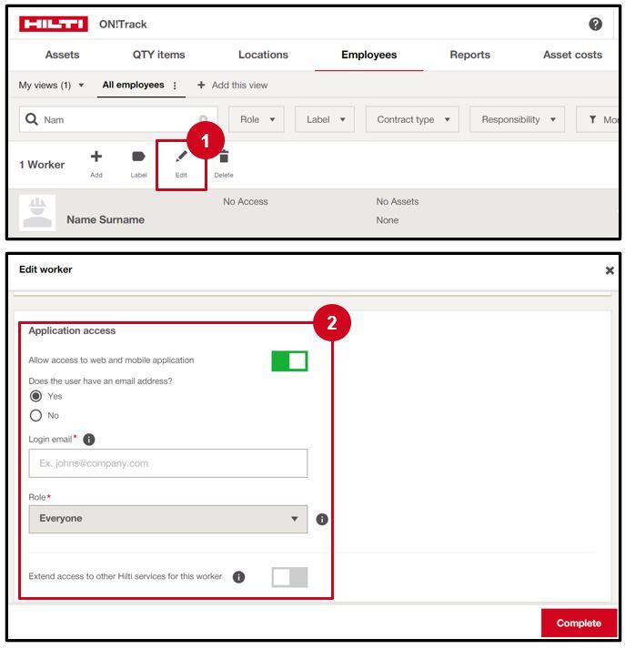

The very first item to be created in ON!Track are the workers, as they are needed to further create locations and then assets. The only mandatory information to create a worker via API is the first and last name but more details can be added such as designation, identification details, contact information and certificates. Not all available data fields in ON!Track are part of the worker API endpoint refer to the API documentation for the worker to have a detailed overview. No worker certificate or attachment can be added via API.
By default, all workers created via API will not be given ON!Track's application access, that can be granted by editing the worker's detail from ON!Track, as shown in the example below:
Workers in the testing account The application access to workers can be given only from a productive account. This operation is not allowed from a testing account.
The current API endpoints allow to create workers from an external system, as well as editing the details of a worker previously created. The delete operations via API is not supported.

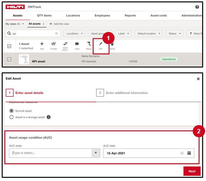

Asset Usage Conditions
The Asset Usage Condition (AUC) is a parameter used to link the status of an asset to its billability. The AUC has these statuses:
- Active: Billable (when assets are transferred to a jobsite, are set to Active by default)
- Bad Weather Condition: Non-Billable
- Not Working: Non-Billable
- Passive: Non-Billable (when assets are transferred to a warehouse, are set to Passive by default)
- Paused: Non-Billable
- Ready to Pick: Non-Billable
The different AUC can be set in ON!Track by editing the relevant asset, and there is also the option to mark the date when the AUC change happened, as shown in the example below:
This information can be then be retrieved via API by the external system, typically an ERP, to trigger relevant accounting-related processes. It is not recommended to set or edit the AUC via API from an external system.

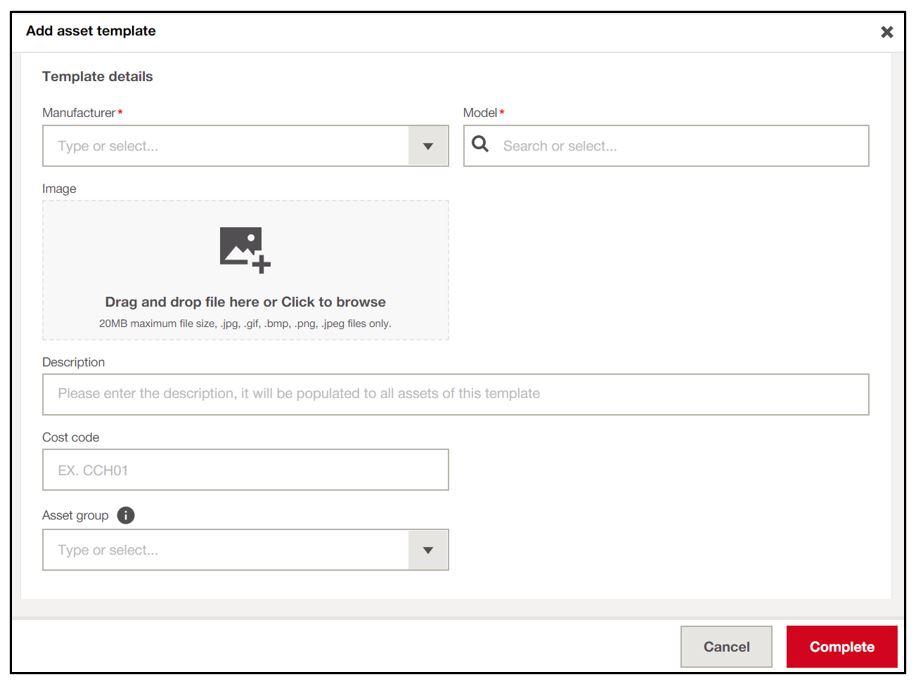

Asset templates
Asset templates allow to pre-define a set of common data to be assigned to all assets with the same manufacturer and model. Using templates eases the creation and editing process of the assets a template is assigned to, as the data entered in template are reflected across all assets that use that template.
When an asset is created or edited via API, it is assigned to a template only when both the Model and the Manufacturer are specified in the API call. If a template for that particular manufacturer and model is already existing in ON!Track, the template is assigned to an asset created via API. In case that the template for that model and manufacturer combination is not existing, the asset creation via API triggers the creation of an asset template.
Working with asset templates and API has the following limitations:
- No asset template data can be modified via API
- The asset data controlled by the template (for example description and group) cannot be modified via API for those assets that have a template assigned

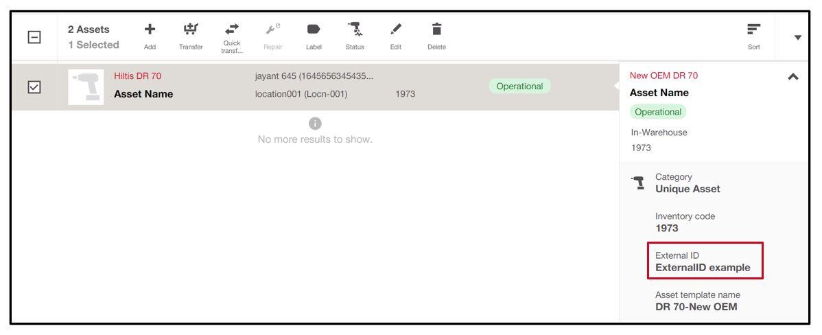

External ID
The External ID represents the unique identification code of an item (workers, locations, assets, and quantity items) used in the external system. It is a field that will be shown in the ON!Track UI only to users that signed for the ON!Track Unite add-on.
For new items created in ON!Track from an external system, the External ID is written directly in ON!Track via API. For all these items that exist both in ON!Track and in the external system, it is recommended to write the same external ID in all items both in ON!Track and in the external system. By doing so, the same item can be correctly matched in the two systems and the creation of duplicates is avoided.
It is also possible for ON!Track customers to search for the External IDs of the external system in the ON!Track Web UI in order to identify an asset.
